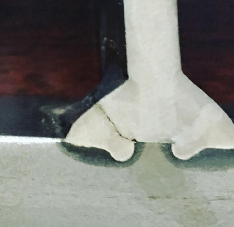

Think of it this way: the intense heat and rapid cooling cycles involved in welding create a dynamic environment where various types of cracking can occur. Some of these “hot cracks” form while the weld metal is still partially or fully liquid. Others, known as “warm cracks,” develop at elevated solid-state temperatures. Then there are “cold cracks,” often associated to the presence of hydrogen, which can appear at or near room temperature, sometimes even hours after the welding is complete.
Beyond these metallurgical cracking issues, fabrication can also introduce non-metallurgical defects. These often result from a lack of precise control over the welding process. Examples include a failure to properly fuse the weld metal with the base material (lack of fusion), the creation of a notch along the weld bead (undercut and overlap), or insufficient penetration into the joint (incomplete penetration). Even the presence of slag trapped within the weld (slag inclusions) falls into this category. Furthermore, improper joint design or poor fit-up of the parts before welding can lead to geometric defects such as “hat cracks.”
Solidification cracking (hot cracking) is a problem with stainless steel welding. Proper filler metal selection is essential.
Solidification cracking (hot cracking) is a problem with stainless steel welding and other nickel alloys, but can also occur in mild steel.

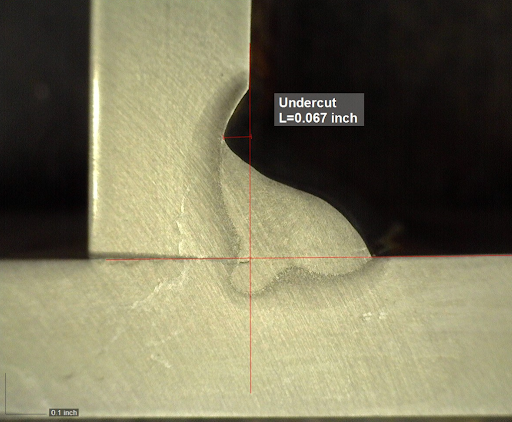

It’s important to recognize that pre-existing fabrication defects can often act as initiation points or accelerators for service-related failures, particularly in cases of fatigue. For example, a welded component may be designed in such a way that it provides infinite life – meaning that it will never fail due to cyclic loading. However, if the fabrication process introduces a notch, such as undercut during welding, it now creates a stress riser that can provide the perfect conditions for crack initiation as it is a stress riser. Additionally, variations in the weld and heat affected zone microstructure, such as localized hard zones, can influence its resistance to mechanical overload or brittle fracture.
Excessive voltage may cause undercut as seen in this weld. The arc energy melts the base material but there is not enough filler metal to fill that void which then results in undercut.  Undercut is dangerous as it can significantly reduce the fatigue life of a welded connection.
