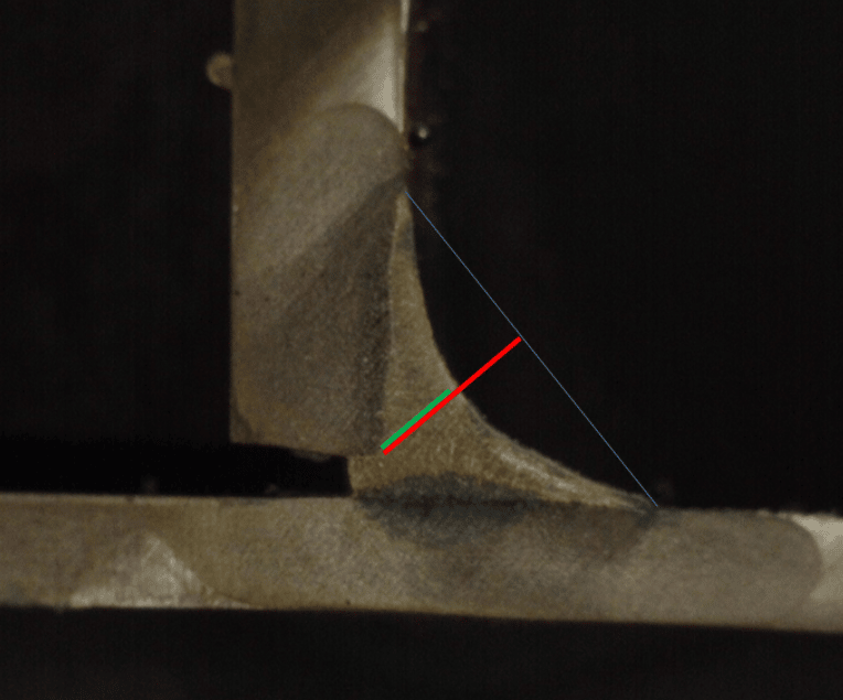

There is nothing wrong with concave welds so long as they attain the desired throat dimension. AWS D1.1/D1.1M:2020 Structural Welding Code (Steel) states that “there is no restriction on concavity as long as minimum weld size (considering both leg and throat) is achieved.” Concave welds with adequate throats are not a problem.
Concave welds are actually good for transferring stresses since they have very smooth transitions at the toes. They are excellent in fatigue loading conditions. The problem comes when the throat dimension is not adequate. If the design calls for a 1/4–inch fillet weld leg size, the assumption is that the weld has a flat face and has a minimum throat dimension of 0.177 inches. If the leg size is achieved, but the weld is concave, the throat will be less than 0.177 inches and thus undersized. This can lead to centerline cracking.
The red line represents the desired dimension of the weld throat. The weld’s concavity creates a reduction in the throat dimension represented by the green line even though the leg sizes are adequate (Assuming there is fusion along the bottom piece which is not the case with this weld). There is a reduction of about 50% in the load carrying capacity of this weld due to its extreme concavity. This can lead to centerline cracking.
Concave welds are also prone to other discontinuities such as incomplete fusion. This is due to the fast travel speeds typically associated with concave welds. The fast travel speed drastically reduces heat input and fusion may be compromised. The figure above shows incomplete fusion on the bottom leg of the weld.

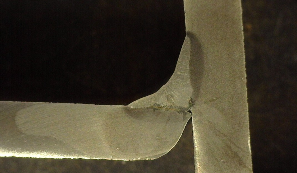

Solution 2: Avoid welding vertical down
Welding in the vertical position with downward progression (vertical down) is conducive to extremely fast travel speeds. Welders speed up in order to prevent the molten weld puddle from rolling ahead of the arc and causing problems like incomplete fusion, spatter and overlap. This is due to gravity forcing the weld metal down at a fast rate. If at all possible, position the part so that it can be welded in the flat or horizontal position.
Weld done in the vertical position with downward progression. The concave weld face is due to the excessive travel speed required when welding downhill to avoid the molten weld puddle from rolling ahead of the arc and creating other issues.
