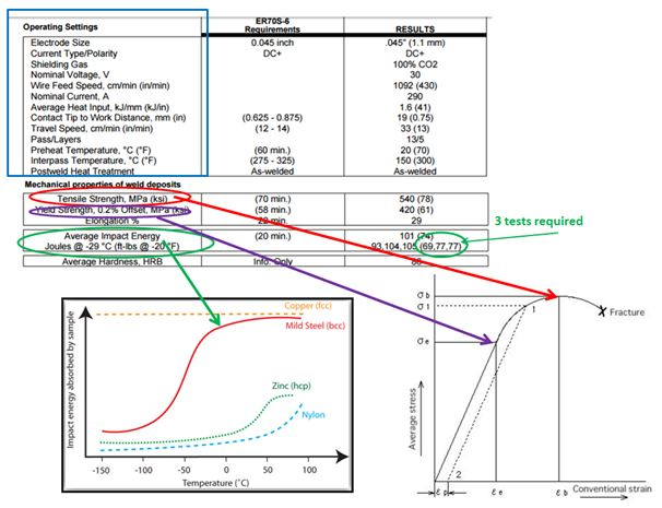

Low temperature service conditions may also require special filler metals. When specific charpy v-notch (notch toughness, or resistance to crack propagation) values are required, the filler metal to be used may not necessarily be a matching filler metal. Manufacturers of filler metal will provide this information in their certificates of conformance. This will let you know if the filler metal being considered will meet the required notch toughness values.
Figure 6.1 – Excerpt from a certificate of conformance for Lincoln Electric’s Super Arc L-56 GMAW filler metal (ER70S-6) and additional graphs for further explanation. The green oval shows the location of the toughness values. In this case the test was done at -20F [-29C]. If in-service conditions will be at much lower temperature a different filler metal may be needed.
A typical requirement may be “50 ft-lb at -40F.” In this case, Super Arc L-56 would not be an option. It may very well be able to achieve 50 ft-lb at -40F, but the certificate of conformance does not provide values for toughness at that temperature. At this point you would have two options: (1) perform a welding procedure qualification tests and test toughness at -40F, or (2) find a filler metal that has already been tested at -40F and provides a minimum of 50 ft-lb at that temperature.
