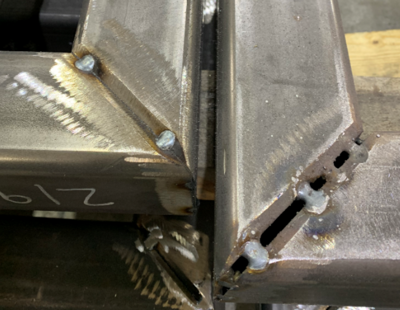

Burn-through is a common defect in welding of light gauge materials. It is typically results in costly scrapping of parts since it can be difficult to fix. Or, if left in place when there are not structural integrity concerns it looks awful and portrays extremely poor quality.
The following is an excerpt from our guide: Weld Troubleshooting for Non-Welding Engineers.
Burn-through is a condition created by excessive penetration that leads to the weld metal being expelled on the backside of the joint. The result is an opening in the joint rather than a weld. This problem is common in welding thin gage materials as well as in open root joints such as those seen in pipe welding.
Burn-through must not be confused with melt-through. Melt-through is the term used for a condition where some weld metal protrudes on the back side of the joint; however, the weld itself is acceptable (there are no holes on the weld or joint). Melt-through is called for in welding symbols and the purpose is to assure that there is adequate penetration. The melt-through confirms the penetration.

Cause: Excessive penetration
Although penetration is usually a good thing, it is not if it is excessive and creates burn-through. Amperage is the essential variable that controls penetration. Thin materials are especially susceptible to burn-through so the welding procedure must control the amperage based on the material thickness.
Solution 1: Decrease amperage
Amperage drives penetration. The higher the amperage the deeper you can penetrate and vice versa. In order to decrease susceptibility to burn-through, reduce the amperage.
Keep in mind that changes to one variable may require adjustments to others. If you decrease amperage you may need to decrease your voltage to maintain the same arc characteristics.
Also, decreasing amperage results in decreased melt-off rate (how quickly the electrode is consumed) and thus a lower deposition rate (the rate at which we deposit weld metal). This means that as you decrease the amperage your weld will get smaller if nothing else changes. This may be acceptable if you are getting burn-through. However, if you are needing to meet a specific weld size you may need to slow down the travel speed.
Cause: Poor fit up
Poor fit up can easily lead to burn-through even on thicker sections. Controlling fit up allows the welder to more easily control the amount of penetration. Having gaps can be a problem. An even bigger problem is when the gap is not consistent. For example, if a gap on 16 gage material varies from 1/32-inch to 1/8–inch, it will make it really hard for the welder to deposit a weld without burn-through. To reduce susceptibility to burn-through improve fit up. This may require an investment in upstream operations, such as bending or cutting operations to make sure that parts fit properly.
Figure 3.9-1 – Inconsistent fit up can lead to burn-through, especially when gaps get too big for the weld parameters being run by the welder.
Solution 1: Improve fit up
Improving fit up is critical, not just to prevent burn through, but to control costs and quality. To improve fit up parts need to be formed, bent and cut well. This sometimes means slowing down upstream operations to assure quality. Other times it means obtaining better cutting equipment or simply training the operator. At times, improving fit up may increase costs, but overall costs tend to be decreased due to reduced rework and more efficient welding operations.
If cutting, forming or bending operations are outsourced, it may be necessary to speak to your supplier and be more strict with your acceptance criteria. If parts are not delivered to you meeting specifications you may need to find a different supplier.
