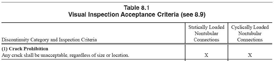

Many welding discontinuities can be tolerated within limits established by welding codes.
For example, structural welding codes may permit limited amounts of porosity, slight undercut, or minor profile variations depending on the application.
Cracks are different.
A crack creates a sharp stress concentration that can continue to grow under cyclic loading or service stresses. Even if the crack is very small, it has the potential to propagate through the weld or base material over time.
For this reason, structural welding codes such as AWS D1.1 generally reject cracks regardless of their length.

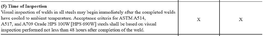

Why Hydrogen Cracks Often Appear Later
One of the defining characteristics of hydrogen cracking is delayed appearance.
Hydrogen atoms remain mobile after welding.
Over time they diffuse toward areas of high triaxial stress within hardened microstructures.
Once sufficient hydrogen accumulates, cracking begins.
This delayed mechanism explains why AWS D1.1 requires certain weld inspections to be delayed after welding to allow time for hydrogen-assisted cracks to develop before final acceptance.
