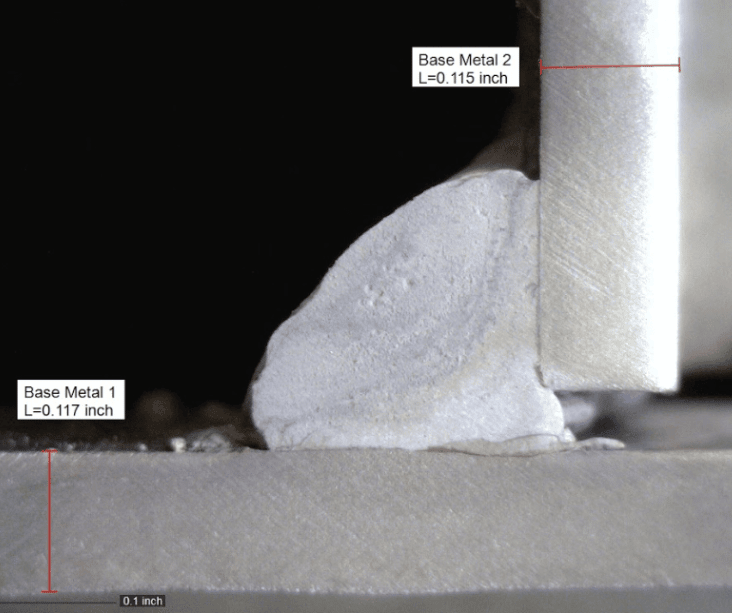

Mistake 1: Not Enough Heat Input
Aluminum’s high thermal conductivity turns it into a very effective heat sink. It pulls heat away from the weld zone much faster than steel. This can lead to “cold” starts, especially with the GMAW (MIG) process, resulting in lack of fusion and a poor bead profile. It’s like trying to start a campfire with wet kindling—the heat just gets sucked away.
The solution? Weld aluminum hot and fast.
This might feel counterintuitive if you’re used to welding steel, but with aluminum, you need to put enough heat into the joint to overcome the rapid dissipation. Many modern welding machines have a hot start or crater fill feature that automatically increases the amperage at the beginning and end of the weld. If your machine has this, use it. If not, you can get a similar effect by starting your weld with slightly higher amperage for the first half-inch before settling into your main welding parameters.

Aluminum reacts instantly with oxygen in the atmosphere to form an aluminum oxide layer. This layer is very tough and provides excellent corrosion resistance, but it has a melting point of over 3,700°F (2,038°C), while the base aluminum melts at a mere 1,220°F (660°C). This creates a significant problem for welding. If the welding arc doesn’t completely break through this oxide layer, it can lead to aluminum oxide inclusions and lack of fusion.
